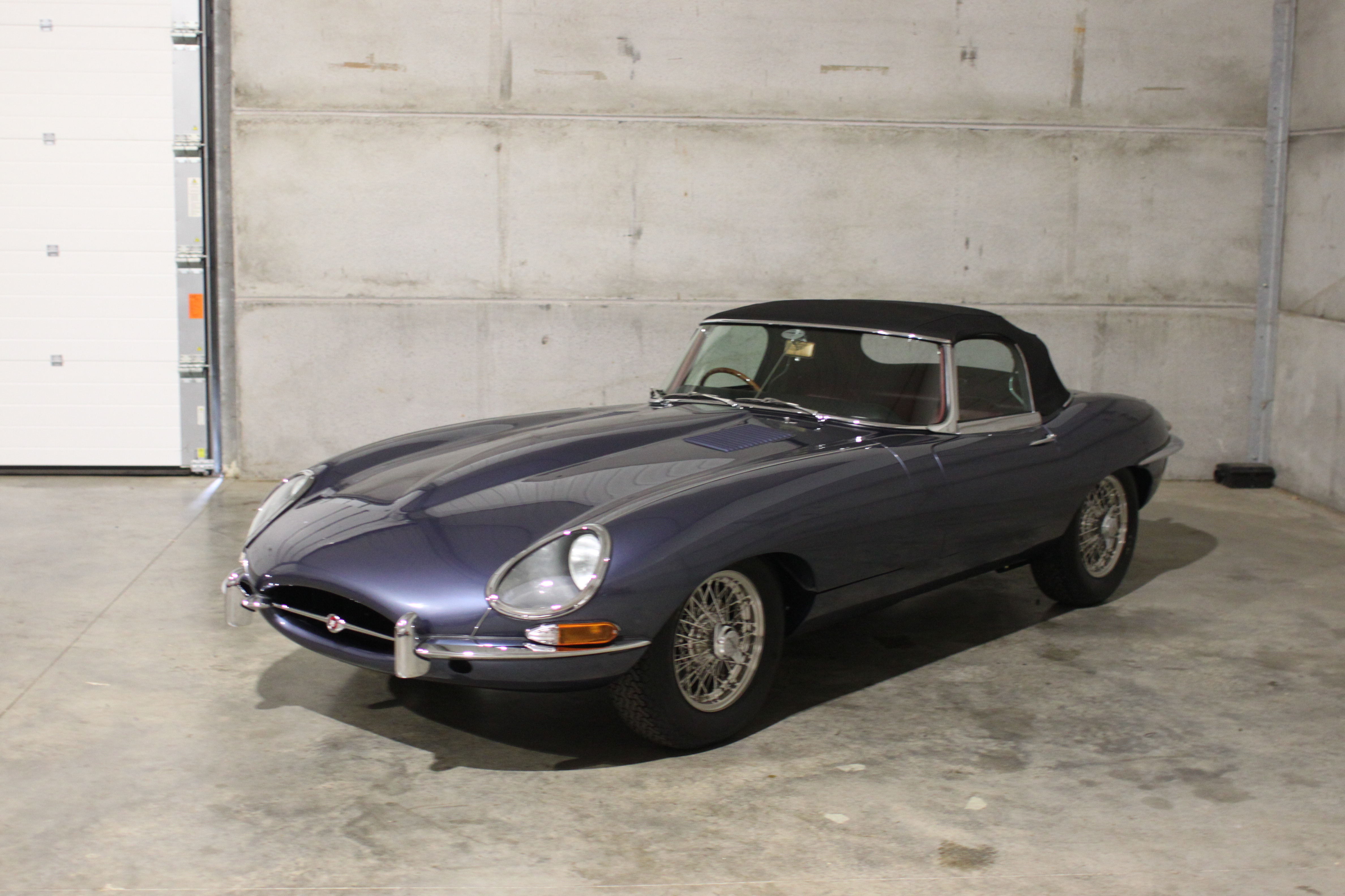

After starting the E-Type for the first time (video on our Facebook), it was sent off to be trimmed. Now back with a stunning Oxblood red interior, we sort out the final details such as shut lines and door mechanisms; then we begin the 500-mile shakedown. For what must feel like an eternity for the eager owner, every niggle is ironed out. This time luck has been on our side, only a few issues have surfaced and perfection is on the horizon.
With a fresh MOT, there are just a few more decisions for the owner to make before we can finish this beautiful OTS and hand it over in time for the summer. For now, please enjoy the latest photos of the almost-complete car!
THE FINISHED PRODUCT
55 years after its day of manufacture, this Series 1 3.8 OTS is now complete once again in its original colour. Please enjoy the final photos of the car in all its glory!
